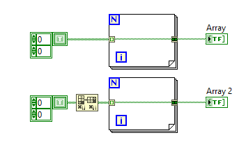

A for loop would also do the trick:
This becomes interesting once you want to selectively convert (e.g. don't add some rows or columns).
