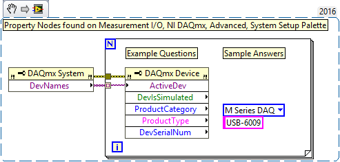

If you are using it in LabVIEW, you may want to know if it is recognized as an attached device by MAX.  The following code works for DAQmx devices (including Simulated Devices), and there may also be similar Property Nodes that will enumerate Cameras (I haven't looked yet).
Note the "Sample Answers" may be mis-leading -- I ran this on my machine, and Product Category, instead of returning an Enum (which I got by right-clicking and saying Create Constant) actually returns an I32.  Incidentally, this is by no means an exhaustive list of the available Properties, just some examples.

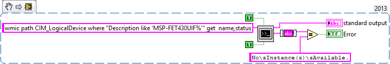

Hello all,
I have managed to get up and running using the following....
Iain

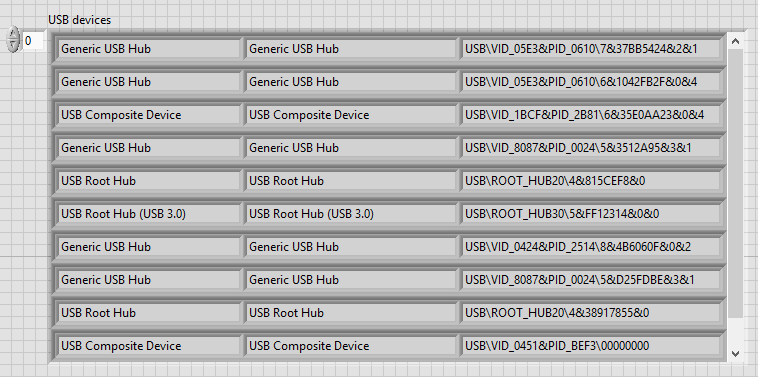

Hello Benoit,
I've not played around with the .net functions.
I'll see if i can amend your code to report the device name as per my example i just uploaded.
when i run your VI the name description are reported as illustrated.USB_Scanner.png
