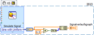

With your suggestions I tried like this but I don’t know how to get a continuous digital sqaure signal (waveform) plot of the converted analog waveform.
Can anyone help me to the required?

You are reducing 1000 samples to a single scalar. You probably should operate on all 1000 elements at each iterations of the loop.

I tried with a "collector" by taking 1000 samples but was unable to get the digital(sqaure pulses) waveform.

If you have 1000 samples, and you want to convert to digital, you are going to get 1000 digital values.  Attached is what I mean.
