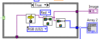

Hi GuenterMueller
That function configures the image. My image is converted from 32-bit RGB to a 8-bit Grayscale as shown in the picture below. I just have to configure the data type of the 2D output array from a 32-bit to a 8 bit.

(6,856 Views)
As uday said above, use image to array after you have extracted the red color channel.

Accepted by topic author Oesen
Please check this. what you have done is not correct(according to me).
-Please use proper wordings for image types
Color-32bit
Gray-8bit
-Intype casting you are using conversion to RGB(U32), Image type should be grayscale there according to your requirement. If the image is color why do you need to typecast again it to RGB??
-After extracting color plane, it is no more color(32bit) image.There is no point in using color image to array. use IMAQ image to array instead.
uday
