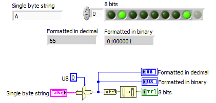

Maybe this is what you are looking for.
Message 6 of 21
(569 Views)
You are getting a single byte, that has the equivalent decimal value in the range of 0..255. You don't get 1-3 decimal characters (bytes)!
For that reason, you should typecast the single character to U8 and extract the bits

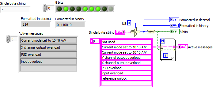

Here's a simple way to e.g. extract the active messages.
