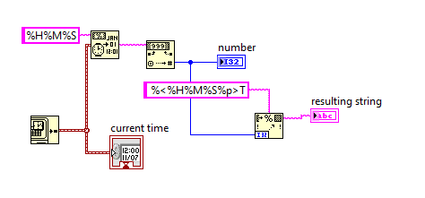

Hi I use the following code to convert timestamp to number and then convert it back to string but it doesn't work.
For example if teh current time is 12:52:30 the number will be 125230 but the the resulting string is   024710 ..  Could you please let me know what is wrong here

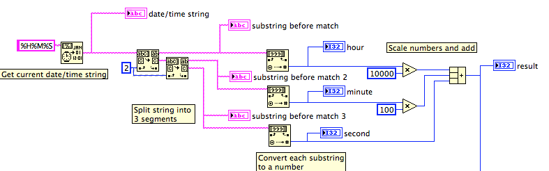

Well, the format of your number has no numerical relationship to the time.
This is the format that it appears that you want:
hour*10000 + minute*100 + second
To get that format you must implement that algorithm. There might be a simpler way but this will work:
Note that the Format Date/Time String function will use the current time if nothing is wired to the timestamp input.

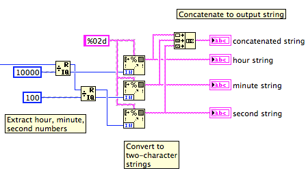

To convert a number in that format to a string you must implement the reverse process of splitting the number into separate values for hours, minutes, and seconds. Then each must be converted to a string. The individual strings can be concatenated to form a single string.
