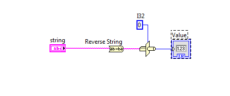

How to convert "8 byte, 2's complement, Least significant byte first" number into a decimal number?
Their driver has the string simply reversed and type-casted into a long integer, and it's output doesn't seem to be accurate.
Actually,  the string is reversed twice in the driver.  I'm not asking why.  but the string data is read, reversed sent to the next subvi and reversed again cast to U32 and multplied by 1e-16.

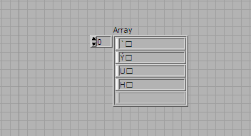

Here's the screenshot of the string outputs

Can you post it as a VI, or a screen shot with hex display turned on?
This is getting more confusing because it looks like you have a total of 8 bytes there after all.  (And they do look like actual binary values rather than the HexCharacter representation.  Which would be a bad idea for a communication protocol that relies on the ASCII characters of CR and LF to terminate a string.
