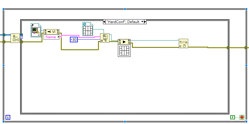

like below. how to make the subVI like that?

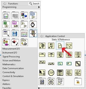

It's also located in "Application Control"

Why when I use this function,  this sub vi did not pop up in front of panel? somewhere wrong?

Assuming that the static reference and the type reference match, that looks OK to me. I just checked a very similar setup and it worked for me.
If you want the subVI to open the panel when it runs, you'll either need to include VI Server functions to open it, or set the VI Properties (specifically Window Appearance > Customize > Show front panel when called) to open the front panel.
Is it possible your VI is working, but that it doesn't have instructions to open the panel?

You need to explicitly open it with a method. The Show Front Panel When Called option does not work (by disign) when called dynamically.
Note that you can open the front panel with a method from the VI itself, and\or from the calling VI.
Closing it when done also needs to be done "manually" .

Not to be contrary, but either I'm misunderstanding (certainly possible) or what you're saying is not true.
Attached is a 2017 project with two VIs, "Caller.vi" and "Callee.vi" in which the caller uses almost exactly (i.e. without Queue and Case Structure) the same code to call "Callee.vi", which is set to Open when called.
Running Caller opens Callee and you can see the inputs correctly passed. Since there is no wait for results, the results are visible but irrelevant to the caller.
p.s. as a follow-up, setting execution to shared clones doesn't change this behaviour - a clone of Callee is opened on each run of Caller.
