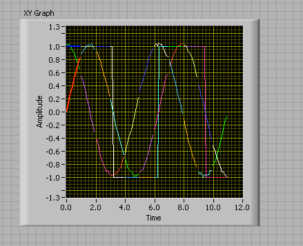

I plan to input 3 continous datasets into a XY graph as the following left image shows. The problem is the XY graph just shows the 10 data points generated in a For loop (see the right image), what I need is to show all the data points genereated before I click the STOP button.

Use a shift register with your while loop.
But I'm not sure what you are trying to do is the best thing.
Why don't you use a chart ?
Da Helmut

Thank you very much for your kind help and I could create a continuous XY Graph now. But the new problem is how to keep the same color for a plot. It seems that different sections of a plot have different colors when I append the new generated data points from the For loop.

Hi ScienceMouse,
You can configure the XY Graph by right clicking on it in the front panel and selecting "Properties". Then you can set various parameters including the ones you want (sorry I use a French version of LabVIEW).
Here is the VI in version 8.2.
Da Helmut
