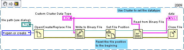

Check out this code. You can write any cluster directly into the write to binary file VI. Then use cluster constant of the same type (or the same cluster)to read the binary data out as the same data type.
-Hunter
(5,837 Views)
Hi Hueter,
Sorry it took so long to respond.  I was sidetracked on other projects.  I am not able to use the cluster method, which is similar to the first attempt.  I had to go back to using the code shown on Feb 2nd.  By the way the code shown on the 2nd does not have the Byte Order constant connected to all the file write functions as they should have been.
Dave
