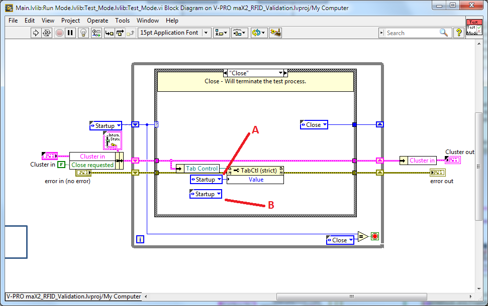

Has anyone figured out how to be able to make a tab Control a strict type so that when I edit the tab names the new names show up such that I can use a property >>> Value node to change tab pages from a sub-VI?
What works for all other types of controls is...
1) Right-click tab control >>> Advanced >>> customize
2) Save it as a type def.
3) Apply changes save all close the control editor and answer yes to replace.
4) Create a reference to the tab control.
5) Create a control from the reference.
6) Repeat steps 1-3 to save the ref as a type def.
7) Put the type defed control of the tab control in a cluster to use in a sub-vi
What I would like to see is that changes to the tab name be reflected in the constants I wire to a property >>> Value node.
What I see in the sub-VI is
A)
The constants created by right-click create control are not type-defs (see no triangle in top left corner)
B)
A constant created on the diagram that has the tab control and copied to the sub-VI DOES have the type-def marking.
A) Disconnecting the constant created from the property node and connecting the constant that created in the top level VI and copied down shows a coercion dot.
So... have any of you figured out how to get the constants in the sub-VI acting on the tab control to adapt to changes to the original tab control?

Strict Type-def BD constants are treated as non-strict.  Basic type def behavior.  You need to watch for that.  Type Def Enums update because the names are part of the data type. But, Tab Names are not part of the data type of the tab container therefore they behave more like rings (and probably should have Ring Constants rather than enums)  Therefore As playing with aputnam zip shows not only does the type-def for the refnum need to be strictly typed the refnum itself must be strict.  (Right-Click the ref control itself and select "Include Data type" - get the red star)
Also, you are going to hit CAR 547900 with that code.  And, don't even try re-ordering the Tabs in the type def, You'll likely crash LabVIEW.
