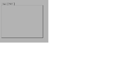

Use a Classic Tab control - set the background to Transparent and the foreground to BlacK.
