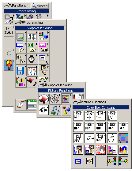

In LV 2010 here's where to find the color box contant :
And in the control palette, you find the color box in the "numeric" subpalette.
In terms of data type, the is no "color" data type, it's a U32, that's why when you create a constant or control or indicator from the node BG color you get a numeric, there might be an idea to change that in the LabVIEW Idea Exchange, I'm not sure...
