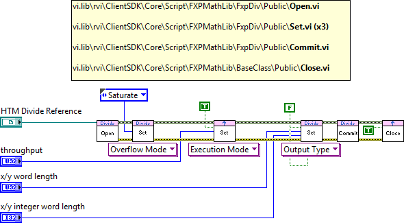

There is a scripting API for the High-Throughput Math Nodes, but it is not officially supported by NI. If you want to dig around in the VIs to figure out how to use it, they are located here:
vi.lib\rvi\ClientSDK\Core\Script\FXPMathLib
Here is a screenshot of some code I have that is setting the overflow mode, execution mode, and output type of a High-Throughput Divide function:
I list the paths of the VIs that are called within the screenshot.
Good luck! And remember, this API is not officially supported.
