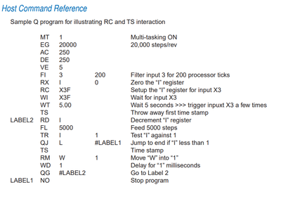

"Q"? Never heard of it... You are going to need to supply a lot more information here...
What is "Q"? It looks sort of like BASIC
What is the device you are programming?
Do you have a programming reference for other programming languages?
What exactly are you trying to do?

thanks,
I thought question was very clear, I already have program for the single command to the motor and response. I would like to create multitasking command so that it can perform the application. Q program is just simple example.

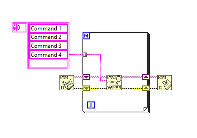

Sounds like you want to create a program that will send a sequence of commands to your device.  As RTSLVU has said, this has nothing to do with multitasking.
If you have a VI that can send one command you want to put it in a loop, then make an array of commands, wire the array to the loop and it will default to auto-indexing the commands into the loop one at a time.  If you were using VISA comms it would be something like this:

So In the array of command the bottom command will be the first command to read, I am sorry, about the confusion how does that array will be read : top to bottom or bottom to top. Can I create toggle to stop the program if there is any trouble.
Message 7 of 9
(3,151 Views)
Top to bottom.
You can enable the "conditional terminal" on the FOR loop to stop the loop early.
