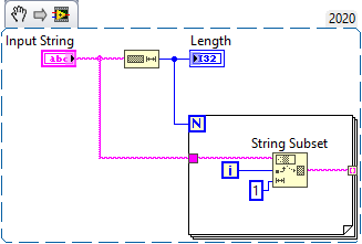

Have you thought about using String Subset?
