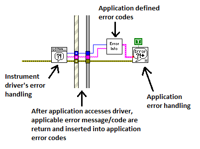

Thanks for all the replies! Now I understand the situation. Here is my workaround solution 🙂
