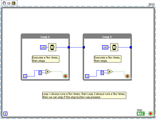

 I want to read and save in tdms file the analog input A0 for 1 second and the analog input A1 for 1 second in daq 6008, but not simultaneously. and that's repeated before pressing the button stops

Something like this?
This is the best I can do without more information.

this 3 loops, are they a while loops?

What you need is a state machine that execute state A then state B until the stop button is pressed.

I think it would be simpler to just acquire both channels and alternatively write to your separate files. You need to stop and clear each task before starting another.

A state machine is the correct architecture, only one loop needed. Simply switch states every desired time interval.
Don't gum up the gears with loops inside loops, etc. It makes the code hard to manage and hard to add functionality later and hard to branch out in case of problems or exceptions.
