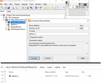

1. I tried to deploy a VI to cRIO by WebDAV and put the VI to /home/lvuser/natinst/bin/ but it was failed as below.

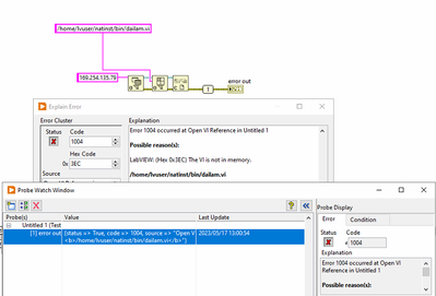

2. Then I tried to load/execute the VI under cRIO via VI server but it was failed also.
ref: https://knowledge.ni.com/KnowledgeArticleDetails?id=kA03q000000YIE4CAO&l=en-VN

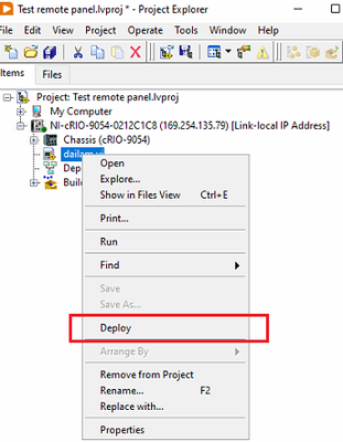

3. I don't know if there is any methods to deploy a VI into the memory of cRIO programmaticallly as the Deploy action in the Project explorer.
Please help me to explain why I get the error in 2. and give me some possible methods for 3.

You need to build and deploy your VI as a startup rtexe. See Configuring Remote Front Panels on a Real-Time Target
