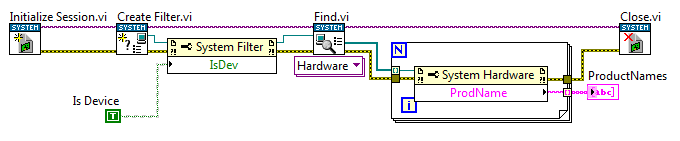

Egemen,
sorry for not reading your initial post properly.
I am not sure about the System Config API features within the versions you have installed. On my machine, the following code works well with simulated devices like the ones you have (cDAQ+modules):
Of course, the list might still include unwanted devices, so you might have to add additional filter options and/or manually selecting devices from the list (array).
This does not reserve the devices! Depending on what you understand by "reserve", you can e.g. create and commit DAQmx tasks on those devices.

Yes you are right Norbert. I tried your previous suggestion and the VI finds devices accurately but the matter is reservation as you said. Even the device is detected, the program could not trigger it. I will look the community solution you sent.
