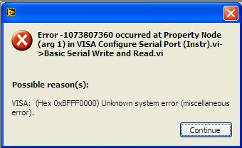

The printer is 'Star DP8340' serial printer. It is connected to the COM1 port through DB9 connector.
I tried to communicate to the device using VISA. But it returned following error.
BUt I am able to print from MS office as well as Labview report generation.
The VISA configuration details such as port name and baud rate are correct, I collected it from the windows printer port configuration. But for some reason, the Labview VISA is unable to communicate.

Ok, I think that the problem is that the OS sees a printer on that com port.
You get the error because you are trying to talk to a serial device on COM1 but the OS is saying you can't do that because there's a printer there. In essence, the com port is tied up or busy because the OS is using to communicate with a printer.

Most likely not easily!
LabVIEW can not access the printer since its port is likely already reserved/opened by the printer driver. VISA actually has a specific error code for ports that are normally opened by another process but the error message is a little unspecific. But most likely the printer driver has reserved the port in some non-standard way and VISA then gets some unexpected error because of that.
And the Windows API doesn't have a simple way to query the state of a printer other than if it is installed or not. An involved way may work, using EnumPrinters() requesting for PRINTER_INFO_2 data and checking the Status element in every returned printer record for the PRINTER_STATUS_OFFLINE flag, but that API doesn't count as easy to interface with the Call Library Node.
