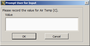

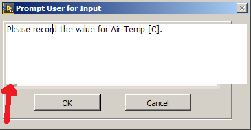

I have a VI whose front panel is shown below where a String Indicator is having an issue. The indicator here reads the value 'Please record the value for Air Temp [C]'.
Problem
When the indicator is clicked on in the front panel the text area becomes 'editable' in appearance (only) and I did not want this
Question
How do I eliminate the behavior shown below in Picture Two, when the indicator displays as editable? How can I leave the system simply in a state of Picture One :)?
Picture One - Normal Front Panel
Picture Two - Front Panel with Click on String Indicator

(Why is the string area in the lower picture so larger? Seems you have overlapping controls. One line would be sufficient.)

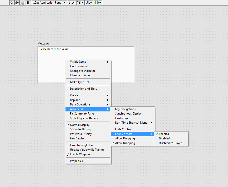

Hi to be more clear refer to the image below
you can right click on the string indicator go to advanced -----> Enabled State and select disabled.
