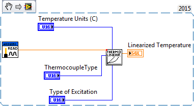

Sure deal, it's pretty simple
You can find it in the Numeric > scaling pallete. It will do all the hard math for you, you only need to provide the thermocouple type, excitation (assuming voltage) and the compensation, all of which can be found in your thermocouple datasheet. It is polymorphic so it will adapt to whatever you input as data source, waveform, array or scalar, I recommend the last one so it can work with Arduino read pin, fill in the blanks with your own specifics and you're all set to go. I would recommend to run it isolated first, and when you're certain it works as you want it to, incorporate into main code.

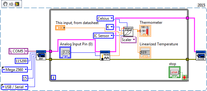

Yeah, no wonder it is showing a zero, you connected the voltage read output to the compensation voltage, which is a flat amount found in your datasheet. This snippet shows the right way to wire, the Arduino output goes to the topmost terminal.

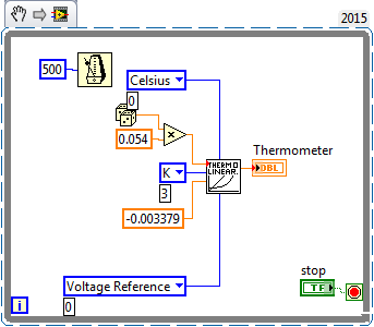

You mention you're using an IC as buffer for the measurement, said IC was manufactured by someone who also must provide a datasheet for it, and in the specs section it must include an example on using it for thermocouple readings, along with the values you need to correctly scale it. Does it do any sort of scaling? Or it delivers the raw voltage? For example a Dataforth B47 delivers a linear signal of 0-5V but the B37 doesn't. Here's a simple example that simulates a type K thermocouple raw reading.
