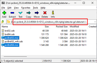

2. Mount or open the ISO with any unpacker and extract the ~1MB ni-pcibrd package in \pool\ni-pcibrd_25.3.0.49364-0+f212_windows_x64.nipkg (the version number will be different depending on your version). The rest of the ISO is not needed anymore.
3. Unpack the .nipkg, either with the NI package manager ("nipkg.exe unpack PACKAGE-PATH [DESTINATION-DIR]") or open it with 7-zip to extract the data.tar.gz and then open the data.tar.gz with any unpacker and extract the pciBrdI32.msi and pciBrdI64.msi files. With 7-zip you can navigate inside nested archives and directly extract the msi files, so it's not necessary to actually extract the data.tar.gz first. The .nipkg format seems to be some kind of cab format and I don't know of any other archiver that can read it except for 7-zip.
4. Uninstall the 32bit or 64bit (or both) ni-pcibrd package using the corresponding msi file (right click -> uninstall or command line: "msiexec /x [MSI-PATH]").
