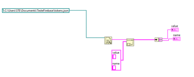

 Hello everyone! I'm tryng to get an especific element from this json file with some controler, but i don't know how to do it, somebody can help me?

The built-in JSON code with LabVIEW is... not great.  You need to pre-define a cluster that EXACTLY matches the JSON, both names and data types, or it doesn't work and you get no values out.
Instead, look into some of the free JSON libraries.

I prefer the i3 one for when I want to manually manipulate JSON and the JDP one for when I want to convert JSON to and from LabVIEW data types (type defined clusters mostly) smoothly.  While that 2nd one might sound similar to the built-in version, it actually runs much better mostly because it's forgiving on inexact matches when parsing.

Another vote for the JDP Science library, it's awesome. If you upload an example json file and what field you want to get out of it I can show you how easy it is in that library.
