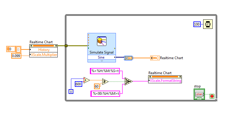

I am wondering if there is any way to display the x-scale limits of a chart in the format HH: MM: SS at all times without the format automatically switching to MM: SS: mSmS before an hour has passed. Currently I am using the code below to do this:
I feel as if this is unneccesary and that there is probably a setting somewhere which I am missing to ensure the display format, as set in the chart properties menu, does not automatically adjust to a new format before an hour has passed. If anybody has a way of doing this without using property nodes (or ideally coding anything), that would be fantastic.

Thanks for the suggestion. Unfortunately, I have tried that already, the problem is that when using the format '%<%H:%M:%S>t' which I believe should be relative time in format hours:minutes:seconds it gives the relative time in minutes:seconds:milliseconds until an hour has passed which is not suitable for my application. Sorry for not making the issue clearer originally, thanks again.

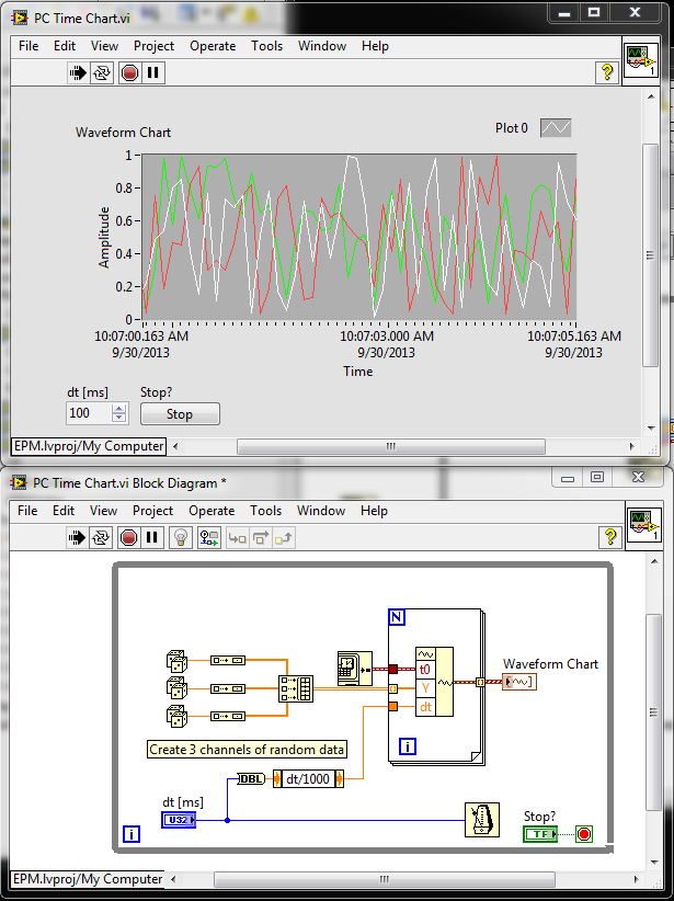

Below is a screenshot of the simplest way I've found to create a waveform chart with PC time.  Works great regardless of loop dt.PC Time Chart

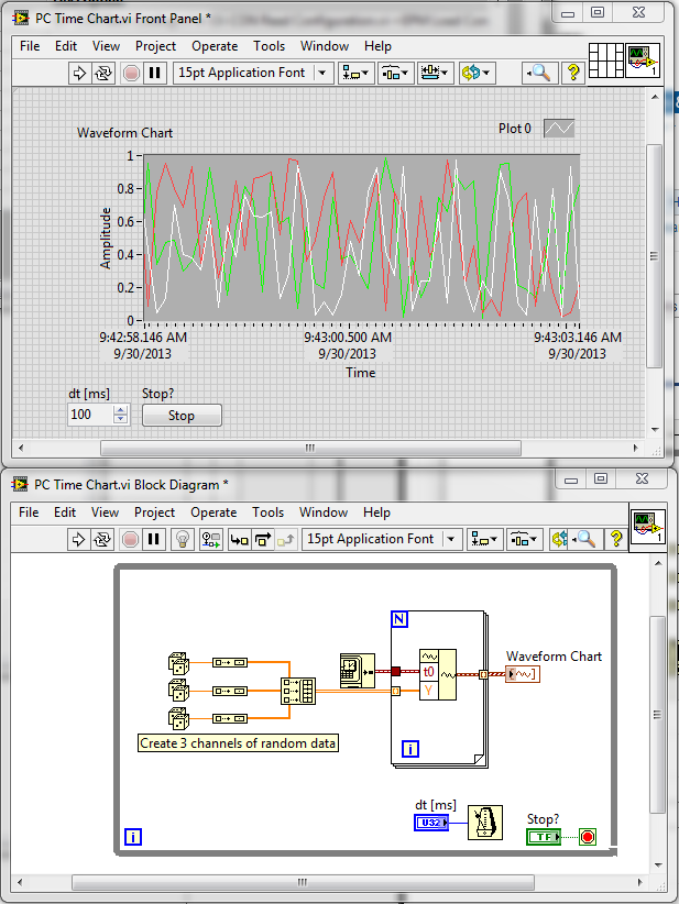

Oops, forget to handle the 'dt'.
PC Time Chart

Why the formula node?  You should just be dividing by 1000.
Message 9 of 10
(5,248 Views)
Personal preference.  The formula node is equivalent to dividing by 1000.  Aesthetically it looks cleaner to me.  Smiley Wink
