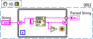

If I understand the problem, you have a string that has a number of embedded commas, and you want an array of strings corresponding to the "stuff" between each comma.  Your reference to 7 "chunks" might imply that each VISA read will return a string of the form x1,x2,x3,x4,x5,x6,x7 (i.e. 7 items, 6 commas), but this solution doesn't care how many "chunks" there are, just that they are comma-separated.
It uses the Match Regular Expression function, with the comma as the Regular Expression.  This VI basically splits the string into two parts, everything before the comma (the upper output, brought out as an array element) and everything else (lower output, put on a Shift Register to be run through again).  Each pass through the While loop pulls off another element, adding it to the array.  When nothing is left, the loop stops.
Consider three odd cases -- string with no comma (get an array of 1 element with the entire string, correct), string starting with a comma (get an array whose first element is an empty string, correct), string of 1 element, ending (or not) with a comma (get an array of 1 element, correct).
Enjoy.
BS
Enjoy.
BS
That does just what I needed!! Thank you
Seems overly complicated. It has already been mentioned that "spreadsheet string to array" is the right tool here (comma delimiter, %s format, 1D string array as type) . No loop needed.
See attached VI. (Image shows that the results are the same for the two versions)
