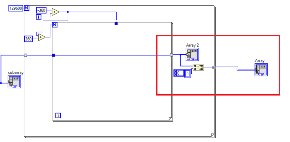

there is a 1Darray of length 129600 and I want to create a 2D array of 360x360 out of it
I'm new to Labview and confused to do it

I tried but was not able to do so can you provide screenshots
I'm confused how to append to array that RED BOX
means I am unable to change default array ([0]) with appended array
I'm new to this

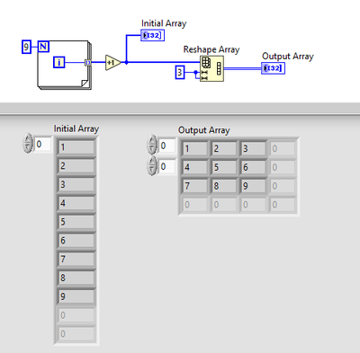

Something like this?

(3,700 Views)
Just wire from one tunnel to the next.  It will go from a 1D array to a 2D array.
