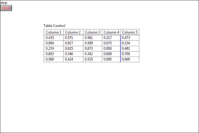

I would like to know how to edit table style in front panel. For the example shown below, I would like to remove the gray color overcast frame.
I couldn't find the table style editor.

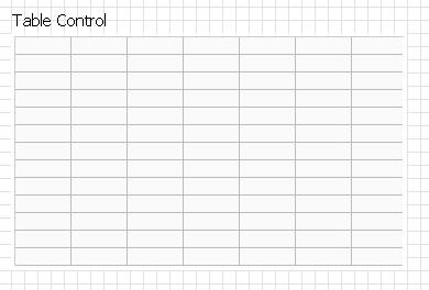

Try using decoration frames. Find the attached vi too
