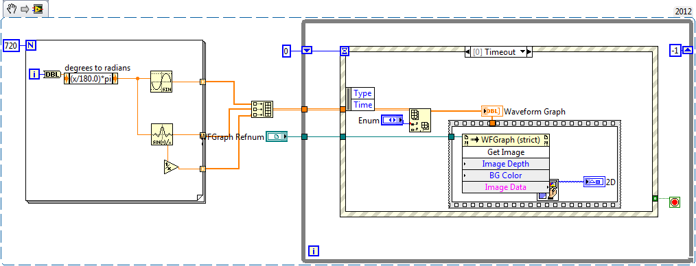

Could you create a png of a graph on the fly to embed on the web page?
