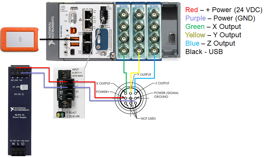

Below is the setup I'm considering which is a cRIO 9030 with three NI 9234 c-modules.
