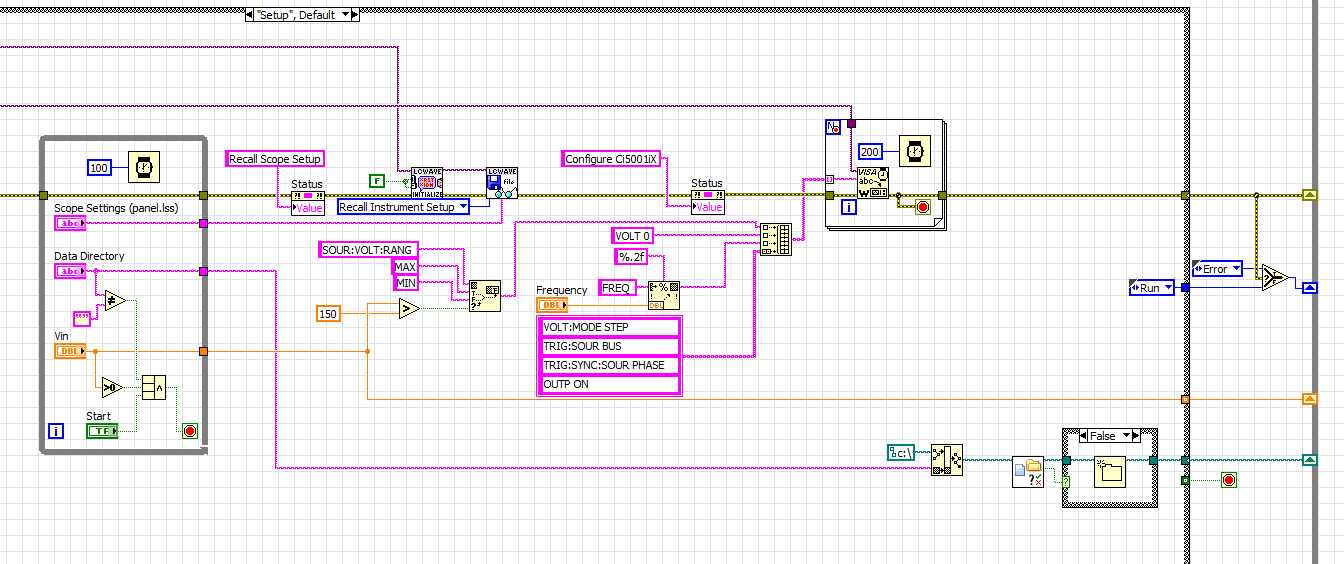

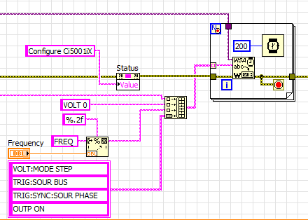

Here is an actual example of the way I write a series of commands to an instrument.
=== Engineer Ambiguously ===
Message 14 of 24
(2,809 Views)
I do the same as RTSLVU.  As far was the wait inside of the loop, some instruments do not need the wait, others need 50ms, others 500ms.  So do not be surprised is something does not work because you did not allow the instrument to do its thing before the next message comes in.
Yeah, I had to add that 200mS because on the older Ci5000 units we have can't take it in any faster. I would get a "comand buffer overflow" error or something like that.
