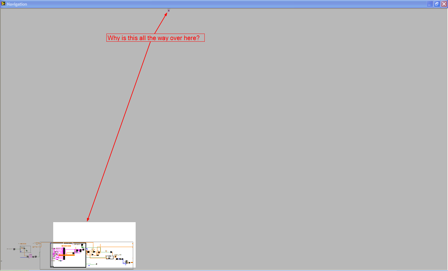

A few things.
Don't do this.  You'll end up in the Rube Goldberg thread...
Do this, instead.
What do you mean by "reduce the time consumption"?  You have a 1 second wait in your loop.
Finally...
Jim
