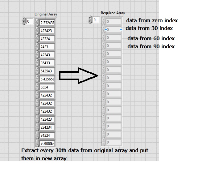

hi ,
sry that i didn't mentioned clearly. What i want is .. i have one array and i will to extract index of multiple of 30 from that array and put them into new array.Please refer my photo below and please advise me how shall i build it. thanks

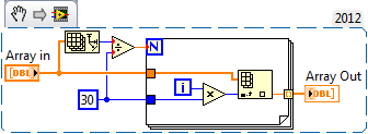

That's why i asked you whats your requirement. Smiley Very Happy
Nevermind, i hope this solves the problem.
Bijay
