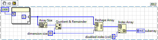

Slightly different approach below:

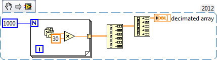

Another solution. You're basically looking for a Decimate Array, but as it felt somewhat difficult to get exactly 1-to-30 i want for 1-to-6 and 1-to-5 for a total of 1-to-30. 😉
/Y
