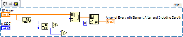

Message 2 of 18
(14,747 Views)
BowenM beat me to it.
Lynn

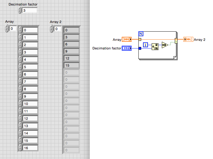

Message 3 of 18
(14,736 Views)
Accepted by libbyherself
For older LabVIEW versions:
(and allowing the compiler to set output array size at FOR loop start…)

Also Reshape Array, then use Index Array to get the row or column of interest.

Thanks for your fast repsonse, i believe this is what im looking for except it wont allow me to wire my array through the loop like you have, error: wire connected to an undirected tunnel appears.... any suggestions?
Message 6 of 18
(14,715 Views)
Message 7 of 18
(14,703 Views)
never mind got it, thanks!!

I think that RavensFan's suggestion of using Reshape Array is usually the best for these kinds of operations.  Note that when indexing you have to wire a zero into the columns index terminal, or the column indexing will be disabled.
Is there any better way to do a roof() function on the array and n?
