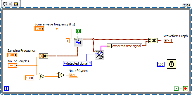

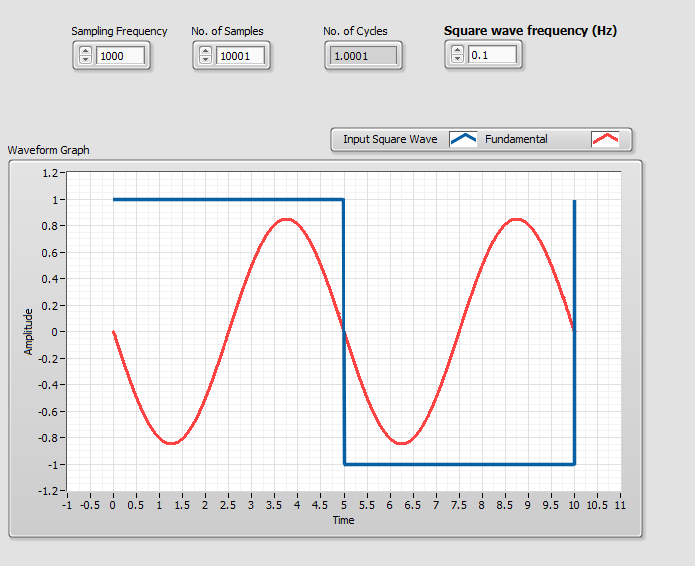

Hi, I want to extract the fundamental waveform from a single cycle of a square waveform. But using square waveform VI I am not getting the correct fundamental waveform.
I thought maybe because since the waveform is not completing a full cycle at t=10 by jumping back to 1. So I had increased the no. of samples by 1 to make the waveform complete, but I am still not getting correct results.
1 Square Wave cycle with an additional Sample1 Square Wave cycle with an additional Sample
Please help with this problem.

You are correct that the single tone extraction fails in this edge case and gives you the first harmonic instead. This is most likely due to limitations of the algorithm, after all, it applies a window function before doing the FFT. (The extract single tone is a VI, so you can see how it does it :D). It does work correctly of you have two or more periods.

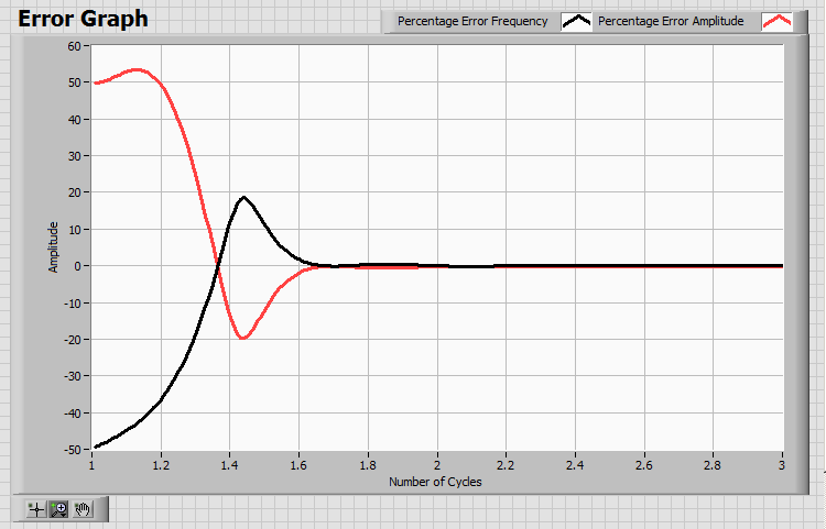

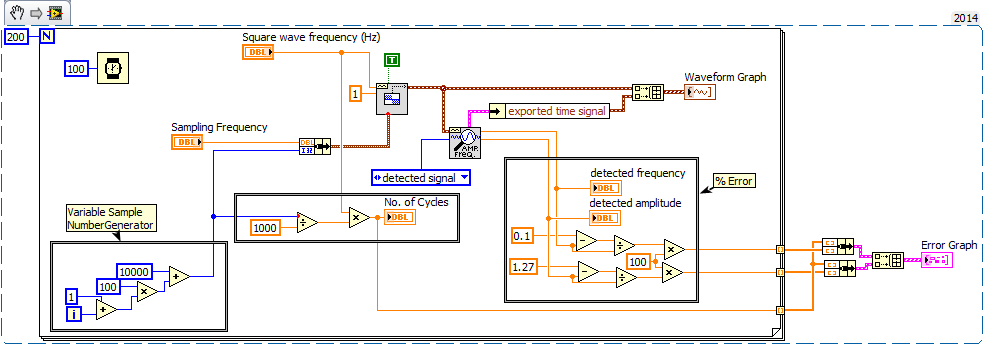

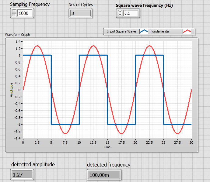

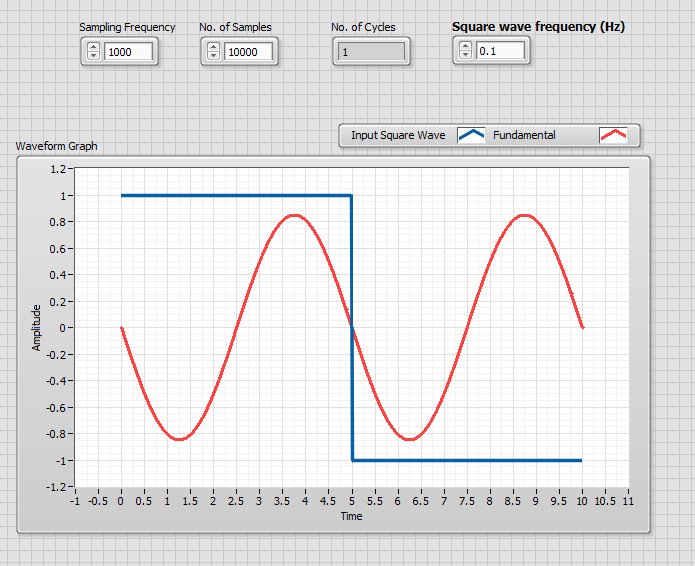

I have noticed the following things after analyzing the working of extract tone VI:
  • It is working perfectly when the number of cycles of the input waveform is an integer. Error in both amplitude and frequency are zero.
  • When the number of cycles of the input waveform is not an integer, the error becomes nearly zero after 2 or more cycles. The following graph shows the percentage error graph of amplitude and frequency.
I think the extract tone VI need at least 2 cycles of the waveform to calculate the correct values. But in my program, I need to calculate the fundamental only with a single cycle of the square waveform. Is it possible?

If you know it is a exactly a single cycle, there is nothing more to measure. The answer is already there, given the time axis.
AsI said, "extract single tone" applies a window function because it cannot assume that you have an integer number of cycles. You use of it is not as intended.

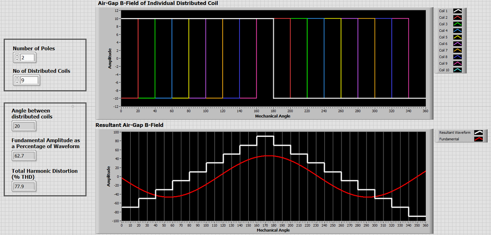

Yes with the only single cycle I can calculate the fundamental frequency which is obviously the signal frequency itself and there is no need of 'extract tone VI'. But here I want to measure amplitude as well.
My application is related to MMF waveform of a distributed winding of an electrical machine.
When the number of poles in the machine is two, I need to generate a single cycle of the square wave.
When many such square waves are displaced from one other with some angle then the resultant waveform resembles a sinusoidal wave with very fewer harmonics. For making a reference sinusoidal wave, I need to extract the fundamental from the resultant and then plot it.
