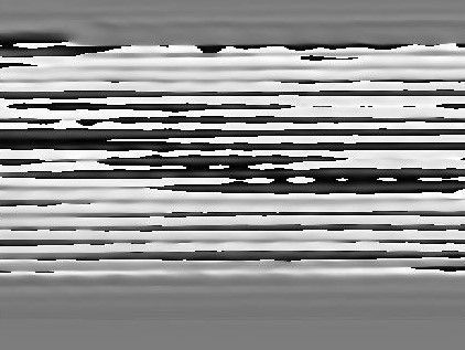

I am new to Labview and would like some help. I want to extract the pixel value of a gray image for subsequent defect detection. How should I write the program?
Like this picture:3.jpg
Please tell me more details,thank you very much!

Assume you do not want to use NI Vision, just want to develop based on LabVIEW basic functions, then
1) use "read JPEG File.vi" read your image;
2) unbundle the image data from the step1 result, if you want to have flatten data;
3) use "Unflatten Pixmap.vi" if you want to unflatten data.

Thank you very much for your answer, but I would also like to take the liberty to ask, what should I do if I need to use Ni vision?
(2,260 Views)
Accepted by topic author Alert77
if you have NI Vision, then you can use "IMAQ GetPixelValue" to obtain the pixel value in you image directly.
(2,231 Views)
Thank you very much! I got the data.
