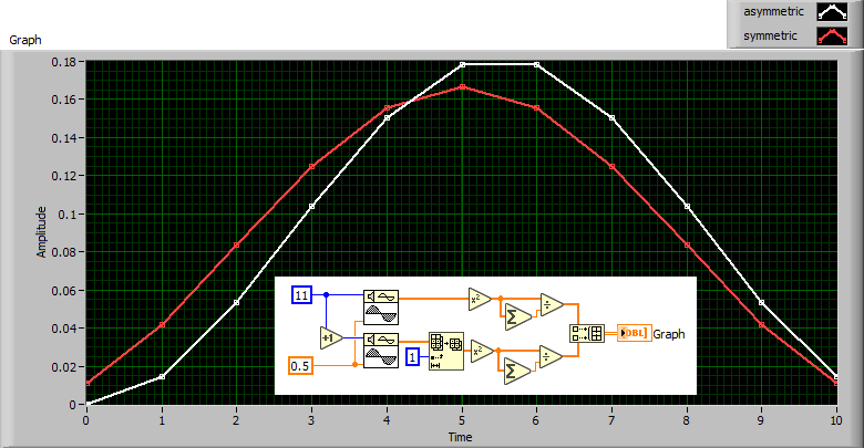

I would like to ask what is the difference between the symmetric kernel and the sine wave kernel that you are using? Is it possible to present the sine wave as a symmetric kernel or this is not necessary?
Message 22 of 41
(404 Views)
Ignoring elements that are zero, both kernels are symmetric. One just has an extra zero on the left which does not add to the convolution and is just ballast and we have one less point that actually contributes. (You can pad the kernel with as many leading and trailing zeroes as you want and the result will not change.)
As you can see, while both functions here have 11 points, the white one actually has only 10 useful points.
(Really asymmetric kernels are of course useful in other situations, for example if your cells would look more like comets with a trailing tail on one side, for example.)
