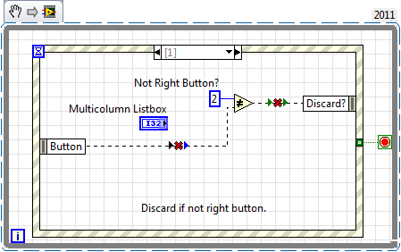

A bit late, will post the snippet anyway. It looks for mouse down? event and discards it if its not a right click (button 2). In the mouse down event, use the property node as tst suggested.
