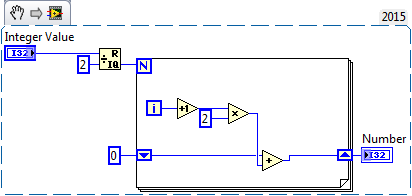

I would use Quotient & Remainder to get the number of loop iterations needed.  Then use a FOR loop with a shift register to keep the sum in.  So each iteration you add (i+1)*2.
@just Implementation is mine (Idea belongs to you @ Crossrulz)
Palanivel Thiruvenkadam | பழனிவேல் திருவெங்கடம்

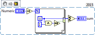

Another way to do this.

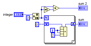

Hi Pala,
two more simple options:
