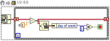

The day of month has a special behavior which allows it to overflow and change the time. I don't think it was put in on purpose.
What you can do is to repeatedly subtract one day from now until you get to Sunday, like so (the d is a unit label):

Thank You!
I had to do a bit of modifying just to get it to midnight but this was basically just what I was looking for.
So simple - and yet it never even crossed my mind!

You will probably also want to account for the case where the code is run on a Sunday.

try this:
I separated calculation of last Sunday from setting time to midnight as I already have a subVI for the last part in my user.lib...
