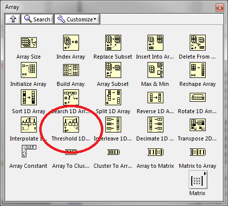

Have you tried threshold 1d Array yet ?

It wasn't working earlier when I tried it, but it just did. Thank you so much!!

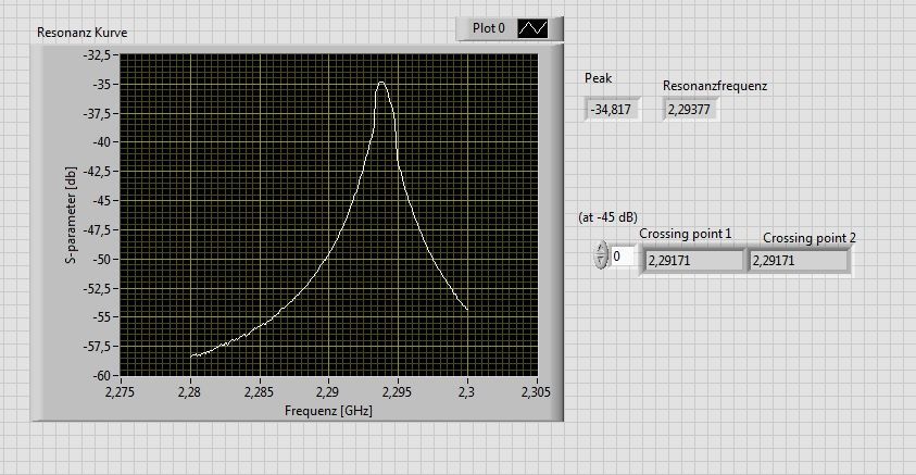

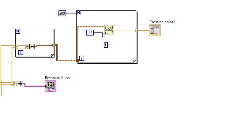

block.jpgUnbenannt.jpgHi, I have tried "threshold 1D Array" to find the 2 interpolated x-values at one certain y-value with for-Loop and while - Loop. But I get only the first x-value (or 2 the same x-value) in the output Array . Can you please tell me how I can fix this Problem?
I have also tried with the Cursor Y at the exact value -45dB but actually I don't know how to fix Cursor Y exactly at one certain Y-value.
(I am learning Labview just for few days and not yet familiar with all functions. Thanks for you help).
Thuy
