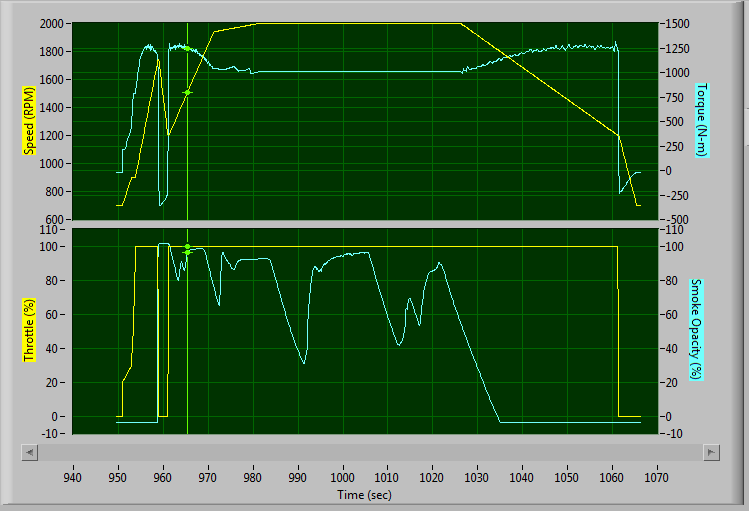

OK, so I'm looking at the relatively-new MIXED SIGNAL graph to fix the things that don't work about the ordinary graph (specifically, the weird cursor behavior).
It looks like I can have one cursor that spans four plots and reads out one X and 4 Y values, that's what I want.
But I need scales on both sides.

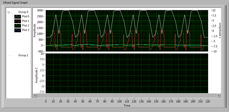

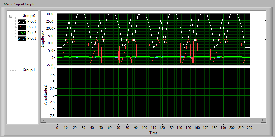

I tried creating the 2nd scale, and SWAPped SIDES with it, and got this:
There's no scale on the right?
 Or is there?
Those little tick marks are a clue.
So I stretch out the right side of the graph, and guess what?
There is the scale:
In other words, the new graph scale stays where it wants to on the screen, even if I horizontally re-size the graph.
I can move the graph, the scale moves with it.  I can re-size the left side, and the left-side scale shows the same effect.
It seems to me like the graph scales should be attached to the plot area.

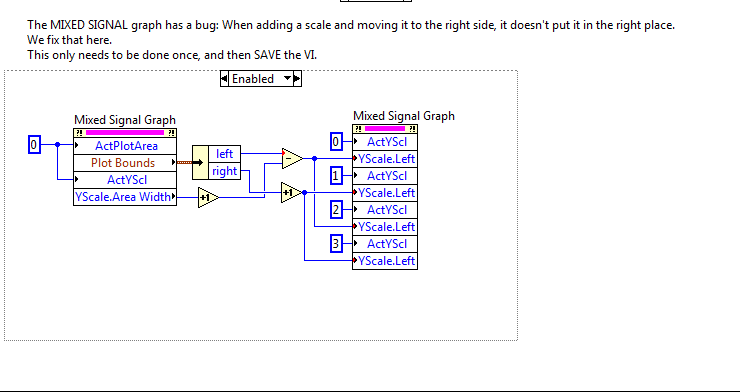

Here's the code I ended up with to fix work around this problem.
The Mixed-Signal graph has ANOTHER problem where it completely forgets your assignments about which plots go on which scales, but that's another story.
In my case, I've already placed the scales on the left / right sides as needed.  It's just that the bottpm right scale, really, really wants to be off to the right.
What I do here is fetch the PLOT BOUNDS for plot area #0 (the top one).
I'm only interested in the left-right axis, I don't have a problem vertically.
I also fetch the SCALE AREA WIDTH from scale 0.
I then adjust the YSCALE.LEFT property of all four scales, to place them where I want them.
The two LEFT scales are at the PLOT BOUNDS.LEFT - (SCALE WIDTH + 1)
The two RIGHT scales are at PLOT BOUNDS.RIGHT + 1
The "+1" means there is one pixel between the tick mark of the scale and the border of the graph itself; I think it looks better.
Just run the VI once to execute this code, then disable the code section, and save the VI. (You don't need to run it again unless something changes; it seems to remember where it's supposed to be).
Of course, if you re-size the graph, you'll have to execute the patch again.
