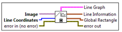

i want to get a line profile. But for that I have to enter the coordinates of the image. How and in what form can I enter the coordinates there? Can I get a simple example from you on how to use this module?

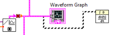

Hi Panther,
have you tried to use the derivative function?
Message 4 of 8
(1,985 Views)
Yes, but i have no idea how can i connect my Graph with the derivative function.

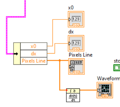

Hi Panther,
use UnbundleByName to get the line data...
Did you look at the context help when moving the mouse over those wires?
Message 6 of 8
(1,972 Views)

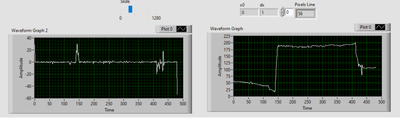

ok thank you for this tip UnbundleByName. I used it and connected it. I get three parameters x0 dx and pixelsline. "x0" is always 1, "dx" is always 0 and pixelsline is variable. I connected pixelsline with the derivative.
and i get a second graph. now is my problem. That the first graph on the right shows a pixel value of 200, but the derived graph on the left shows a value of 30. Do you know why?
thank You
Message 7 of 8
(1,945 Views)
You calculated the first derivative of that line. Do you know what that means?
The biggest chance between two adjoining data-points seems to about 30, so that's the max value on the derivative graph.
