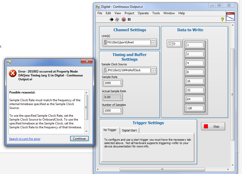

Anyway, I am now finding out, that I do not know how to properly set the clock source. I have got this error when using refClock and if I use Onboard clock, it returns error too...
I am using PXI-6251
Martin

Hi Martin,
do you really need to start with a sample rate of 10MHz?
As the error message clearly says you are beyond the hardware limits here.
For learning purposes you might start with sample rates of 1kHz!

Yes, you are right, but then I would get this error...
Martin

Hi Martin,
does the example VI use a "10MHzRefClock"?
Don't wire the clock input for a test (or try a different clock)…

Well, I am force to have there source. First, it is done in this example and second, it does not work without it.
Message 9 of 10
(4,701 Views)

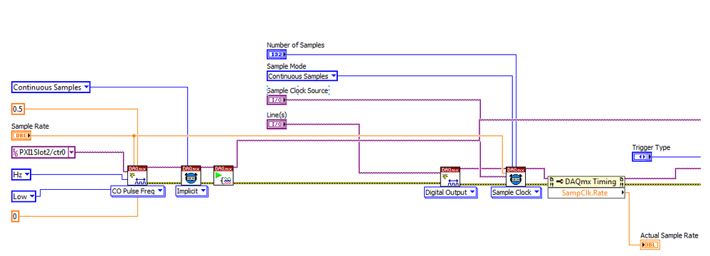

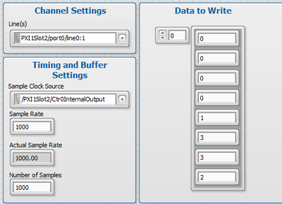

So for this case with PXI-6251 there are two options for digital output with internal clock I tried:
  • to use 100 kHz timebase with possibility to dived this timebase by 1-16 ratio
  • to use counter internal clock as recommended above - with Lines PXI1Slot2/port0/line0:1 and data write array (U8 data) for creating reqired signal pattern (0 - low state on both lines; 1 - high state on line0; 2 - high state on line 1; 3 - high state on both lines 0,1)
Martin
