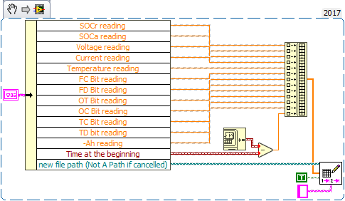

i trying to export the readings of my program into spreadsheet but I have a problem with a Time Value. The problem finds place in the "Release data" state.
Time Value is exported as a decimal number and not as a time format, as I want it to be. Check my files.

Hi vlado,
Yes, your description is true: there is a problem in this case of your case structure!
Did you also notice the big red coercion dot at the WriteSpreadsheet function?
When you want to save waveforms you should use the WriteWaveforms function!
(And why do you need to create several waveforms containing just one sample?)

thanks for your advice.
I made it as you told me, but I still don't get a proper values in the spreadsheet. I want it to be saved automatically into time format hh:mm:ss and not as a decimal number.
Well, I think it is practical for a logging file. Do you have any advice how otherwise i can do it?

Hi vlado,
Please define "proper" values! I think you get correct values…
Then you cannot save your data as CSV files (aka spreadsheet data)!
When you want to use certain Excel features like cell formatting you need to save your data as real Excel files - either using RGT (ReportGenerationToolkit), the underlying ActiveX calls or third-party toolkits available in VIPM…
You can save times in the format
HH:MM:SS
in a CSV file, just not using Write Delimited Spreadsheet.vi, since it can only use the one format specifier for all cells (in this case the default, %.3f). Instead you can use something like Format Into File, specifying the desired format for the time using Time Format String codes (e.g. %<%H:%M:%S>T ). Excel will correctly interpret times in the format
HH:MM:SS
One problem I've run into is that if you include fractional seconds, e.g.
HH:MM:SS.ff
, since Excel doesn't have a predefined display format for this, it'll hide the hours and just show you
MM:SS.ff
, and if you then resave the file in Excel format, it'll forget the hours completely. The fix is, as soon as you open the file in Excel, to immediately create a custom display format for your time column that includes hours, minutes, seconds, and fractional seconds.
You do know in Excel you can just highlight the column, right click, and select "Format Cells", then select the time format you want, right?
BTW: If this does not work then the "numbers" you are saving are NOT a proper timestamp.

A LabVIEW timestamp is the number of seconds since 01/01/1904 00:00:00.000 UTC, but an Excel "serial date" is the number of days since 1/1/1900, so you can't just save a LabVIEW timestamp and have Excel understand it without doing some math. If you're writing a CSV file, it makes sense to put the date in a human-readable format that Excel can understand, like hours:minutes:seconds.
