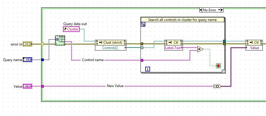

I just stumbled upon this very old topic because of a similar problem. Due to the fact that no solution was posted here I would like to add my solution. In this solution I wanted to select a cluster element by a Enum that contains all cluster element names. The VI used to convert the Enum values into string is from the OpenG package.
So if somebody is still looking for a solution to this problem, here is mine:diagram.jpg

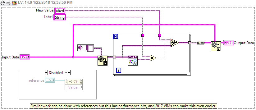

There are multiple ways of doing this today.  Using OpenG is fine if you know you will have it installed, but I prefer a native solution if one is possible.  Here is my quick attempt which does the same thing of setting the control named String to abcd.  If this is done in 2017 you can even take advantage of VIMs and have the type propagation happen in the VI.  Otherwise there are a few experimental XNodes (undocumented use with caution) that can do similar work.
