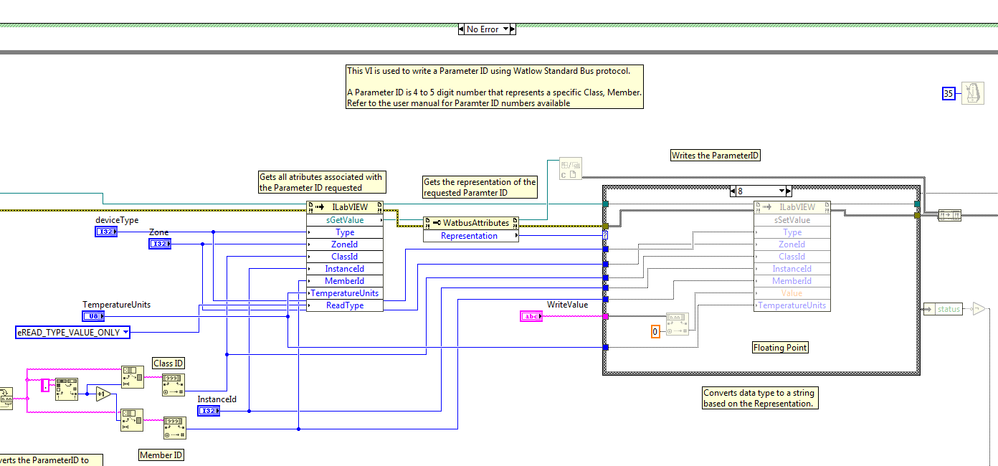

Well that Close Reference node isn't right anyway - the reference is being closed and, before or after this, then the last Invoke node is called. There are no constraints put on what order those two nodes should execute (ie dataflow) so that should be fixed at least or that the Close Ref is after the Invoke node. This wouldn't cause a hang however; when the bug asserts itself you would just get an error on the last Invoke node.
EDIT: Actually when I download the API I see that the picture you show is *not* what the Write VI looks like - the Close Ref is attached to the WatbusAttributes Property node, not the ILabVIEW reference wire. Make sure you revert the Write VI back to its original state so that you don't end up with the bug you have shown.

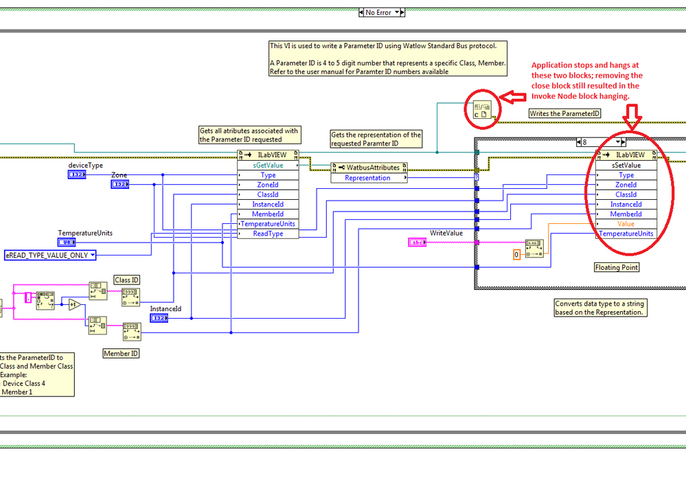

Sorry! I used the wrong file for a screenshot, good eye! I did do some playing around with the std_Bus_Write.vi, trying to gain insight as to what the problem was, and I took a screenshot of this file, instead of the original. This problem occurs with the original std_bus_write.vi. See another screenshot from run-time, below, which shows a little more precisely where LabView stops executing:
I've also simplified testing code (attached) as you recommended. I am still seeing the same issue with LabView failing to resume execution at the locations shown in the screenshot above.

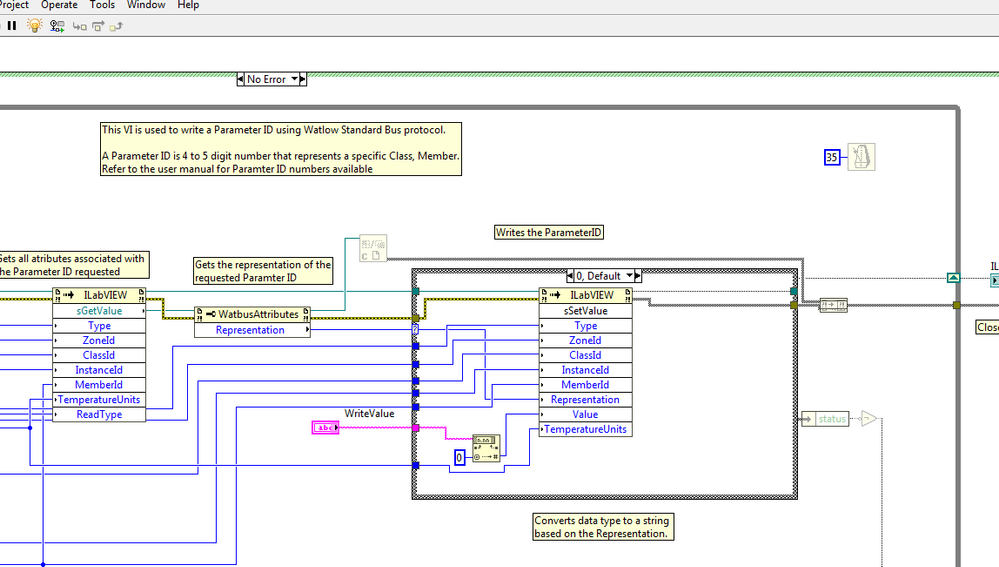

EDIT: So keeping the std_bus_write.vi block diagram open during execution makes the flow appear to stop at slightly different positions. I've included this below, in case it is at all relevant:

I believe that running the VI with execution highlighting enabled forces the VI to execute on the user interface thread explicitly for many nodes, which is why, when it is enabled, it seems as if the VI doesn't actually execute most things in parallel. It puts you into a position where attempting to observe the behavior influences its results, just like most debugging in a way. To help with consistency you are better off using probes at various places in the dataflow to observe whether the probe is updated or not, giving you the information to determine where the block diagram is up to without the impact on execution that highlighting enforces.
You'll also find that once a thread crosses the boundary into the .NET CLR the Abort button / Ctrl-. may not work under all circumstances, depending on the implementation in the .NET assembly. If the .NET assembly code uses asynchronous or signalling primitives then it is possible that the currently executing thread cannot be requested to "abort"; in fact I believe that the abort will only work once a thread has finished executing its current "clump" of LabVIEW code assigned to it by the current execution system.
