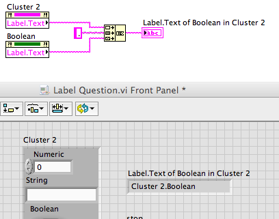

Use two property nodes. One for the cluster and one for the boolean. Concatenate the resulting strings.
Lynn
